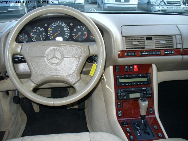

A oto moja ukochana!!
[IMG]http://www.w114-115.org.pl/forum/img01/res_1245867290_1.jpg[IMG] <br>Dodano po 2 minutach.:<br> http://www.w114-115.org.pl/forum/img01/ ... 060461.jpg
