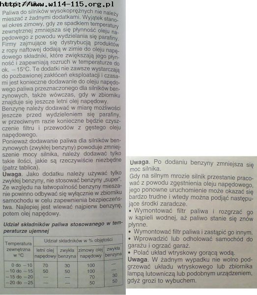

http://www.w114-115.org.pl/forum/img01/ ... dazima.jpg [zlosnikz]
